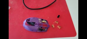

anyone have a teardown for the top plastics to replace the rmb/lmb switches?
Update (07/24/24)
its not a setting in software, its a physical problem with the buttons
i managed to get it apart and replace the switches (this solved the problem)
there were 3 hidden screws that hold the battery compartment plastics
and then 4 screws to remove the button plastics, and 2 more screws to hold movement limiters
then 2 screws for each of the rmb/lmb button pcb
then unsoldering and replacing the switches was an easy task
also repaced the forward/back buttons while in there, since tha was only 1 more screw for their pcb hold down

You need to buy new switches for the mouse, unsolder the old switches and then solder new one to replace defective one. It's pretty easy if you know how to solder and desolder but could be tedious otherwise. I did it for 2 oy my 305 mouse and upgraded the switches for better quality ones, it's pretty much the only thing that will fail on the 305 since they cheaped out on the quality of the switches for that model.

Completely forgot about this. I ended up ordering Kailh GM 8.0 switches and replace both sides while I was at it. Works perfectly fine again and I like their clickyness better than the originals.

I had the same problem as you. This might sound wild but if you are going to replace the switch anyway you might try to:
0) Open the mouse entirely until you reaches the switches
1) Open de actual switch without desoldering it (you can but its not necessary)
[You can open it using something sharp enough to fit between a plastic tab and the base. You'll need to apply very little force to lift the two tabs on the sides]
2) Now you have two options:
2.1) You can just scrape the copper that makes contact with the switch's terminal
(Some oxide might have form between plates due to humidity)
[Safe and easy, but you will need a very thin sandpaper to fit between plates]
2.2) You have to extract the metal piece, scrape it with a sandpaper/nail sandpaper and place it again. You can also try to bend a bit an specific part, which acts as a spring and is already bent, to increase a bit the strenght needed to click
(Well, a bit risky because if you don't blend it properly, it will lose strenght instad of gaining. Also it is a bit difficult to place back the metal piece, I would recommend you to take some photos of how it was placed at the beginning to take reference)
In my case this worked perfectly, i did it 5 times with 2 different mousses and 4 switches. As you migh be thinking, the first time went horrible, but because i didn't know any of these (I blent wrongly the metal piece making it to loose strenght, once I put everything back, everything worked perfectly despite of the loosen strenght of the click. I could barely rest my hand on the click without activating it .
Also, that extra one (that 5⁰) was a second attempt to solve my first mistake, I did it the better I could and totally recovered the losen strenght on the click
I hope it helps you! Let me know if it worked for you!
(I also reapired my scroll later, which was in fact useless, with a similar technique 😁)
