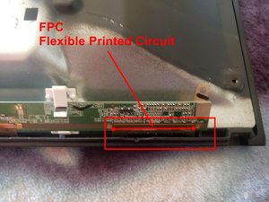

@ericreyes59663 that is the crux of the thing.
Those are FPC or Flexible Printed Circuit's They are fastened to the LCD via a special process. Take a look at something like this video about how it is done.
You do want to avoid those boards (FPC) from coming off. Whenever I work on a LCD panel, I secure those boards to the panel with some painters tapes or similar.
Also, those driver boards always correspond to the T-con board. Check on here and that is just based on the number on your driver boards.That is how things get matched up and that is why we can't just pop in another panel. They do have to match. If we could change those driver boards then we could just use any panel and a matching T-con board. Companies would not like that. It'll cut into their profit.
I do hope this answers what you were asking :-) No forgiving necessary. We are all in this together. We are all learning and sharing. Can't learn if you don't ask :-) Remember what's important:
