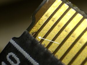

I had this on my D-pad cable:
I couldn't find this with the naked eye, after inspecting everything I tried using a magnifying glass, and voila - I found it.
What worked for me was cleaning the space between contacts with a needle.
