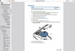

Here’s the maintenance and service guide for the laptop. Go to p.103 to view the procedure to remove the RTC battery.

Update (10/31/23)
Hi @laptopuser2012
It works when I selected it just now.
Here's an image of the page
(click on image)
@jayeff the maintenance and service guide says "page not found"
