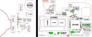

my phone stopped vibrating even when it is on vibrate mode. how to fix it?

If still no good it may be a hardware problem:
a). Here's an image of the Vibrate motor troubleshooting flowchart from the service manual and also zoomed in and normal size images of the board layout showing the location of the components mentioned in the flowchart.
(click on image)
If it is determined that the vibrate motor is faulty here's a teardown video for the phone that will help. The vibrate motor can be seen being removed at 3:11 minutes into the video.
Search online for GH31-00746A to find suppliers that suit you best.
