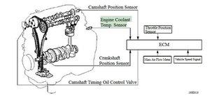

Why can't I find my coolant temp sensor
I have looked everywhere for this thing and I can not find it. I have a 02 toyota camry SE manual. Could you help?
Hi @candie71426
What model engine is in the car?
If it is an 1MZ-FE here's an image showing the location of the coolant temp sensor.
(click on image).
If it is a 2AZ-FE engine then the manual is not as explicit
(click on image)
