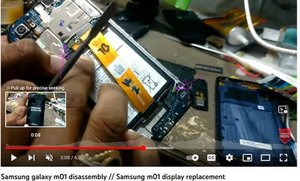

My mobile can't connect to WiFi like my other moblie
My mobile can't connect to WiFi like other mobile and it can't connect nearby WiFi by little far distance and it catches network only in one direction

Hi @svgshreyas
Try using the phone's WiFi as close as possible to the network router i.e. <10cm and check if there is a stable connection.
If there is, then it may be an antenna problem in the phone, loose or faulty antenna perhaps.
Here's an image from this teardown video that shows both ends of the antenna and where they're connected to on the boards.
9click on image)
