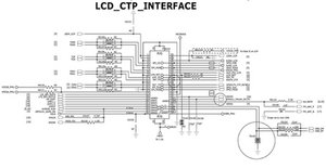

My screen is blue and I can't use it
Pls show me how to repair
Screen is blue and then l can see
Phone screen is dead

Phone screen dead and screen is blue line and black line

If your phone is this kind of problem first check it the screen to board connection is properly. and then if it's not fixed in this change the another screen fit to that model.

It is most likely an issue with the display. I'd start by replacing the screen. Since iFixit does not yet have a guide for this, use something like this video to replace it. Replacement screen are readily available at many online stores.
It is possible that this is caused by a failure of the video circuitry on your main board, so for that we need to rule out the display. If a new display does not resolve this, then the issue most likely requires a boardlevel repair. Here is the schematic for components around the LCD connector
