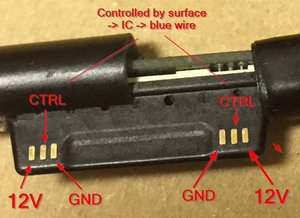

As we can see from the picture, the output of your charger is 15V DC, so that's what we should expect to see on a voltmeter. Looking further, we can see that the Surface has a funky connector, so now we have to figure out where to take that voltage measurement. Luckily, someone over at StackExchange has already gone to the trouble of figuring it out for us, so here's their picture.
They've labelled the photo as being 12V, which is incorrect for your charger, but it does tell us where to look. The red probe of the voltmeter goes on the pad marked 12V and the black probe should be touching the pad marked GND, or ground. There are two of each, so it wouldn't hurt to check both, but if either one is working the charger is indeed putting out the correct power.
