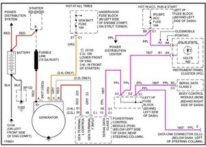

I just put a new alternator in and a brand new battery and the battery light on my dash still on,😲 can anybody please tell me why? TY

Here's an image of the charging circuit for a 1999-2005 Grand Am that may also help if the above tests are both OK. Perhaps check if the wire colours/terminals on the alternator (generator in diagram) shown in the diagram match the the wire colours/terminals what is connected to your alternator.
(click on image)
