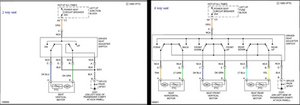

Why won't my front driver side seat go up and down
The driver side front power seat won't move up and down
Power seats may have three motors; tilt, forward/reverse and height, switches for each motor, one main fuse. Presuming the other motors work, this leaves the switch, wiring, motor and mechanism to consider.
Hi @joebealldonk
Here's the wiring diagram for both the 2 way and the 6 way power seat circuit (you didn't specify which) for the vehicle, that may help.
(click on image)
