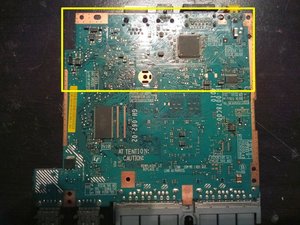

I've tested all of the main points and just random spots throughout the board with power plugged in and the power flows through the whole thing but still, when I have it all together it doesn't turn on, like the little led on doesn't turn on. I thought maybe the led was out so I tried to turn it on while it was connected to the tv but nothing happened. I was wondering if this is a possible fix because everywhere I look online just says to solder the power plug joints back to the board but there not broken.
Update (01/22/2023)
of the bottom of the board
of the top of the board
another of the top
Update (01/22/2023)
okay, the one outlined in red is a bit resistant (its coming up about a 15-20 on my multimeter), and the blue one has no continuity at all.

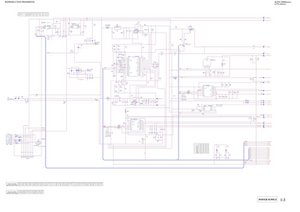

@octopie I am not really convinced about the random tests and the 18V being good. Use a multimeter to check for continuity (and voltage) of the fuses. Of course, look for any charred, burned, or missing component as well. Here is the schematic for the power supply. Go ahead and test the voltages on that.
It's a big scan. Download the image and open in your image viewer

@octopie looks like there maybe some damage on the board.
Check and see what is going on in that area
Update (01/29/2023)
@octopie let's see this area (yellow outline) from both sides. Nice head-on pictures. That all looks like there is something going on. Water damage possibly, but it could just be my old eyes.
i think this is the board from a 70xxx model I have a 790xx
I don't know if the boards are the same and just moved around or something but half of these fuses arent there or near where they are in the picture :/
@octopie easy fix, we'll delete the image. Post a couple of good ones of your board. Lets see what we can find out. I know it's a lot of back and forth but as you can see, online fixing is a bit different. So, don't get frustrated and remember that
