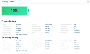

Here you can see what lenovo vantage should look like with batteries installed (Mine is a T480 with dual batteries installed).
If yours doesn't show this, you're kind of screwed unless you shell out for yet another battery (As far as i can tell you've already bought 2).
Alternatively, what does windows battery bar say (Bottom right where the battery icon is or in the control centre thingy of windows 11). If that's fine then HWinfo seems to be acting funky.
If not however, you might just be unlucky 2x as i don't know of a battery controller on lenovo's (At least the ones i own which are the T480 and an S730)

Checking Lenovo Vantage is actually a good idea, that I unfortunately did not think of with the aftermarket batteries. (And I've since already returned them for a refund.)
Then again, mine actually shows a lot less info than yours. And specifically, it has less information than the Windows battery report, at least for the official Lenovo battery. (I see no manufacturer for example, although maybe that's just hidden when the manufacturer is Lenovo.)
The data that is there is mostly in line with the Windows battery report.
