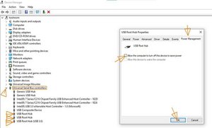

Go to Device Manager - Universal serial bus controllers - click on > to expand the list - right click on USB Root Hub - Properties - Power Management and uncheck "Allow the computer to turn off this device to save power" - OK.
Do this for all the Root Hub entries shown.
Then restart the laptop in the normal manner and check if the pendrive is now detected.
To get to Device Manager in Win10, press the Win key and the x key (both together) and click on the Device Manager link that shows in the options menu.
Here's an image that shows what it looks like. It is from my desktop PC but the USB Root Hub Power Management settings are the same for Windows OS.
(click on image)
