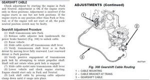

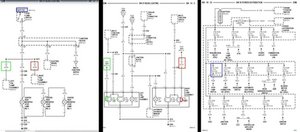

Won't shift from Park to any gear and no brake lights
Won't shift into gear from Park to any gear no brake lights replace the brake light switch and still same problem

Did you check if the stop light fuse (Fuse G - 20A) in the fuse block is OK you didn't say?
If the fuse is OK, here's the stop light wiring diagram from the 1998-2000 Durango service manual that shows the wiring for the stop lights.
(click on image to enlarge)
Regarding the gears, check if the gearshift cable is OK. Here's the adjustment procedure.
