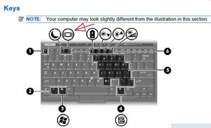

If you can't see any images try connecting an external monitor to the laptop's vga port and when the laptop has booted into the OS press the Fn key + the display toggle key (both together) and check if there is a display showing on it. (see image below)
(click on image to enlarge)
If there is a display on the external monitor then there may be a problem on the motherboard, the cable connecting the motherboard to the display or in the display.
If you can't see a display on the external monitor then there is a problem with the GPU or the motherboard.
