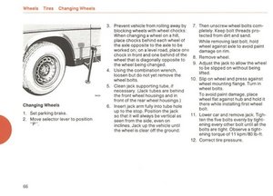

What's approved way to change flat tire w123?
What is proper way to jack 300td and change a flat tire?
Hi,
Here’s an image taken from the 1984 Mercedes Benz 300TD owner manual that shows how to change a wheel.
(click on image to enlarge)
