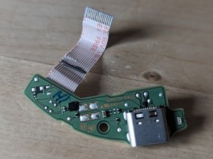

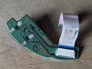

I have a different issue. My headphones don't turn on at all. No faint light or anything.
They also don't seem to charge. There is no red light turning on when I plug it in.
I checked the USB board visually but it seems fine.
Also the battery seems fine visually and I tried to unplug it for 20mim or so. Nothing changed.
The flexcable connecting the USB board with the Mainboard in the right earspears looks a little suspicious. It looked like this already before I pulled it out. Maybe that's the issue? 🤔
I just don't know where to get the right one. I'm located in Germany.
Does someone have an idea?
Hi, you are right, I think the ribbon cable is broken. You can either try replacing it or if your hands are steady enough and you have the tools to do the job you can try repairing the connections with solder and wires. Just make sure to isolate the connections after you are done.
