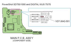

Somebody woke up this old question ;-) so here is an image of where the fuse is located
i cant find that f601 fuse
where is it?
