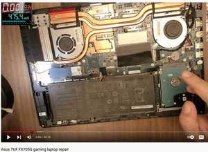

Remove the RTC coin cell battery from the motherboard. Remember the orientation of the battery (+ve on top - when the battery is out measure its voltage. If it is <2.5V DC replace it. The battery type is printed on the battery e.g. CR2032.
Here’s an image taken from a video for the laptop, showing the location of the RTC battery.
(click on image to enlarge)
Press and hold the Power button for a full 30 seconds and then release it.
Reinsert the RTC coin cell battery (remember the orientation), reconnect the main battery, reassemble the laptop, connect the charger and try turning it on.

why don't i have an rtc battery on my model? i have a asus tuf gaming f15(2023), i don't see any rtc battery here
