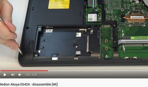

Try using the laptop as close as possible to your WiFi router i.e. <25cm and check if you can detect your network.
If you can then you have an antenna problem. Perhaps it is loose from the WLAN card.
I couldn’t find a teardown video for your model but found one for a Akoya E6424 which may help.
Here’s an image from the video showing the WLAN card (I think) and the black and white antenna cables going to it.
(click on image to enlarge)

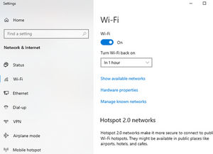

@jayeff ive placed the router directly close to laptop, no changes appear. i think that problem more possible laying in software, because connection by Wifi doesn’t even want to turn on to find any possible wifi networks.
the system just doesn’t want to turn it on, after clicking ,in settings or in networks panel, on wifi connection, the “turn on” position holds for few seconds and then just switching back to “turned off” (as on the images below)
on the second image its turned on but as soon as i refresh the page it changes back..
