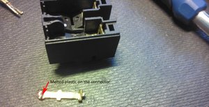

OK, I fixed it !
Kevin Sargent and jayeff thanks forhelp. Before read your comments, i did not know the parts of a Grinder, and without your help i could not fix it.
When i dissasemble the trigger switch i looked for a moving part. There was one, but its movement did not affect anything. There was two pairs of terminals (down and up) but seperated and the movement of the switch did not affect either. Because this was not normal, i suspect that one pair of the contacts must have been stucked somehow. Althought i might damage the switch, i took a tweezers and pulled up the “down” connector, and It came off and came to its physical position, where the two pairs of connectors were touch eachother. (what was happened, really it was that when i pulled up, everything ejected from their position and for several minutes i tried to figure out what part were, in which potition) And when switch change position, connectors seperate from each other. .......CONTINUE IN NEXT COMMENT
...........What was hapened it was that the plastic was melt and the metal got stuck into the plastik. This was because , i had the trigger switch in the second position (the one that somebody have not to hold it all the time). As i noticed, in this position, the “down” connectors comes down (to the very far position) and touch the plastic. This do not happen in the first position , where you must hold the switch all the time. So in this far position (where touching the plastic), after some minutes the metal connectors were get hot, and melt the plastic.
So to avoide from this happen again, i place a litle piece of Alouminium tape in the area where (in the far position), the connectors touch the plastick. I stuck the Aluminium with silicon, and i hope that it will not move from there, cousing other problems.

You may have to be careful that the aluminium can carry the current required for the motor.
Over time it may oxidize and create a resistive surface which may become hot and/or prevent the motor from turning due to the increased resistance or the voltage drop (heat) across it.
Given the cost of a replacement switch it may be better in the long term to simply replace the switch.
