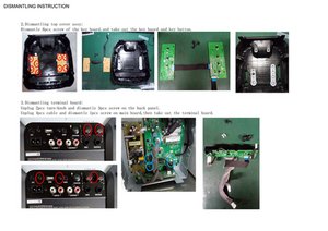

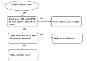

@onelots you have checked the "no-Power" flowchart and checked the voltage on FB40? You've tried a reset? Post some good pictures of the "alimentation plate" so we can see what you see and hopefully we can figure out where the sound comes from. Adding images to an existing question

Next you would need to start checking for the power situation. You all said that you have identical problems, so I suggest that you all check the voltages according to this

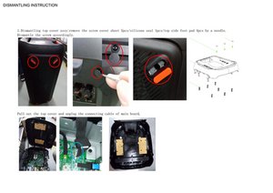

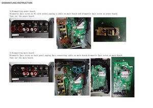

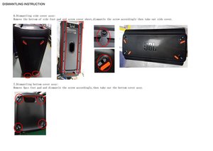

To get to your boards etc. use these images for the disassembly
Hola todos, tengo el mismo problema, pero indagando encuentro que no tengo los 5v sys que van desde los ic U1 y U58, si alguien pudiera confirmar nos ayudaría
