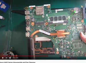

Remove the RTC (Real Time Clock) battery from the motherboard and leave out for about 5 minutes. Remember the orientation of the battery for when you have to reinsert it. Usually it is +ve on top (marked on battery). Here’s a video showing the disassembly of the laptop. The RTC battery is located on the underside of the motherboard so it will have to be removed to access it. Here’s an image taken from the video that shows where it is. Also when the battery is out measure the voltage of the battery. If it is <2.6V DC, replace it. The battery type is marked on the battery itself (usually a CR2032 or CR2026 available most everywhere). This battery (non rechargeable, lasts ~5years) maintains the BIOS settings when the laptop is off and when it is low the settings may become corrupted preventing a normal start.
(click on image to enlarge for better viewing)
