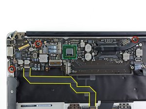

A common issue with older batteries is they swell up as they get old. Some really expand quite a lot! When that happens the battery presses against the bottom cover and the upper case pressing on the trackpad.
So what can happen is the bottom cover pops off or which I suspect happened here damages the trackpad and/or the trackpad cable!
This series uses the trackpad as a way station for the keyboard signals and both the keyboard and trackpad signals are then passed to the logic board via a single cable.
So… You’ll need to start by replacing the MacBook Air 11" (Mid 2011-Mid 2012) Trackpad Cable
Then if that doesn’t fix things replace there trackpad MacBook Air 11" (Mid 2011-Mid 2012) Trackpad Here’s the guide MacBook Air 11" Mid 2012 Trackpad Replacement

I just replaced the flex cable and everything is just as it was before. Should I go for the trackpad then?
Yes, that's the next action.
