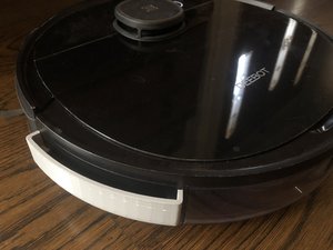

It is not listed here, so I choose the closest to my model number. I would like to know how I can change the Ecovacs newer model Deebot Ozmo 950 (with mopping) . I would like to do this myself. Please help!
There are two screws right behind the front wheel, holding the battery compartment. Simply open it and pull the connector of the battery.
This Version is pretty similar to the Deebot 900 but still slightly different. On the bottom side you need to remove the cover with 8 screws (slightly shaking the plate to help it get loose):

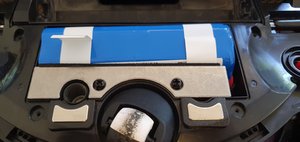

After this you can already see the battery behind a metal block with two screews:
Try to lift the metal block after unscrewing (lifting the battery at its two white strips slightly might help here)

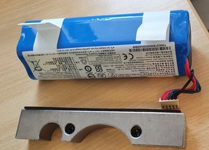

Then unplug the cable and there is the battery:

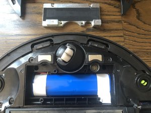

and the bot looks empty:

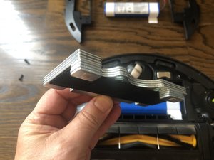

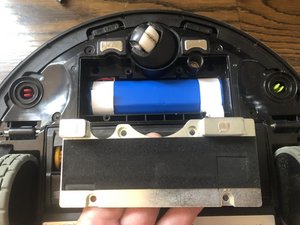

I have a 920, which is only slightly different than the 950.
Cover removal is the same, but the metal block securing the battery covers the entire thing.
It's substantial too!

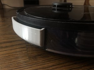

Also several years back after first purchasing this, I modeled/printed this exhaust manifold to clip onto the exhaust vent. Because the side exit exhaust design is just plain silly.
