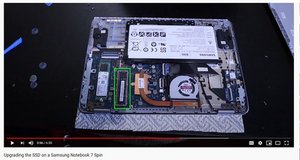

I thought I could add RAM to this notebook. It has 8GB and I was trying to upgrade to 16. Either I was wrong about being able to add it or I’m blind. I took off the back cover, removed the battery, even looked under the motherboard and could not find any RAM sticks to replace. The Samsung user manual is absolutely no help.
Anyone know where the RAM is? Thanks so much.
Hi,
According to the specifications for the laptop, it has 8GB of onboard LPDDR3 memory.
Usually onboard means that it is hard mounted i.e. non-removable, onto the motherboard and the memory cannot be upgraded etc. unless there are spare memory slots on the motherboard.
Here’s an image taken from a Samsung Spin 7 SSD upgrade video showing where I think the ram is located on the board. I may be wrong about that as I cannot zoom in too well.
(click on image to enlarge for better viewing)
If your motherboard looks similar check what is printed on the barcode sticker (if there is one) shown in the highlighted box and search online using the information as it may reveal what it is. Just a thought.
Indeed, I think you are right. I also have a ~730QAA. I have spoken with Samsung support, which has informed me that memory is not updatable on the NP730QAA-K02US. They also informed me that the installed SSD is not upgradeable.
I would be curious about upgrading anyway -- soldering and ensuring the computer can recognize the new RAM ICs...
A la: https://gregdavill.github.io/posts/dell-...
Or perhaps others have tried something like this.
@Peter Gorvitz
The SSD (component to the left of the ram highlighted in the image above) looks like it is connected to an M.2 slot so you should be able to install a greater capacity sata M.2 SSD.
I assume that it is keyed as an "m" key slot but it may also be a b + m. You would have to check
As for the ram that may be problematical as it may also be limited in BIOS
