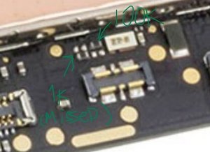

Had same issue. It's looks like I cracked some small SMD resistor near battery connector (1K value). Soldered larger size SMD resistor with thin wire (can't find same size, only 0805), and tremperature started to read correctly (checked with Accubattery app). Hope it helps.
