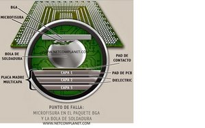

This is going to be either a bad NVIDIA or GPU solders and needs to be reflowed. I own mobilemactechs.com and I do them all the time for $250.
Is that really worthwhile, considering you can buy a new board for $200, and reflows are not reliable and generally fail after a matter of months, at best?
You have bga problem, need rework or reballing this bga chip.This solve your problem.
I´m in Spain,www.netcomplanet.com , we have a profesional bga rework machine to do this work,if you need contact us.
