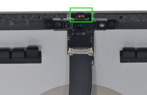

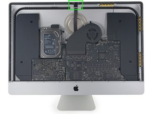

This might be a little weird, I’m trying to get pictures and specific idea of where the microphone is on this iMac. I’ve tried various sources it seem that almost no one is interested in the on-board input microphone I'm trying to see:
  • Its route into the logic board or what have you?
  • Where is it situated as apple support claim it to be beneath the apple logo but by the quality of recordings I’m not sure.
As you can see I’m not very experienced at these things and it has been years since I used an iMac let alone looked at internals and would extremely appreciate any kind of help.
Apple does tend to hide it well! In this series the microphone is with the iSight camera logic. A small slit in the aluminum case and a channel created by the adhesive strips to the edge of the glass and case. You can see it here:

I don't think Apple is offering a true stereo mic setup. Apple can surprise us moving things about. The 2015 & 2017 models had the mic on the top. It's possible the mic was moved to the bottom. Sorry for misleading you ;-{

Actually this answer is incorrect.
As of the 2017 model(so includes 2019 models), it’s as follows:
The Isight camera is still located as mentioned at the top of the display.
The microphone and cable are located at the bottom of the Imac, about 1/3rd from the right.
It’s connected with a tiny flatcable to the logic board.
But has anyone encountered the muffled recording after reassembly making sure the adhesive tape is not covering the mic?
Haven't yet sealed this 2019 21.5" 4K iMac that I'm working on yet but it seems muffled even without ANY adhesive on the screen anywhere at all, just tape and a service wedge holding it in while I test. It is possible that I don't have tje display perfectly aligned.. not sure how the sound is supposed to get from the user into the microphone in this location. I know the previous models had a small cutout in the aluminum, maybe this model has passthroughs in the display?
Same Problem with 5 iMac 27"; muffled mics without been covering by adhesives...
Did you push the old adhesive into the hole or use a solvent which dripped in?
Carefully remove the microphone assembly and use a toothpick to clean the holes.
