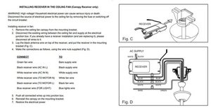

Here’s an image that may help with installing the new receiver board, maybe.
You may have to check the model number of the receiver board and then try to find a replacement by searching online for Hampton Bay (insert receiver board model number) receiver board, to find suppliers of a suitable replacement. There should be an installation guide with the replacement board
(click on image to enlarge for better viewing)

I found the repair manual specifically for this fan online (“Manslib”) after I located the Owner’s Manual filed away when the fan was purchased.
Looks like I know what I’ll be doing this upcoming Saturday.
