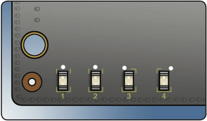

Also, locate the onboard diagnostic LED’s hidden under the tape
