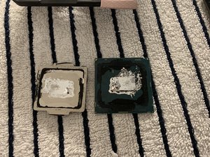

@frederik.juul.eilersen I'm still waiting for the adhesive to arrive. After that, I got everything I need to proceed :)
I told you I was gonna go all in on the cooling, so I even bought sandpaper to sand down the IHS until its shiny.
This is either going to be the coolest iMac ever, or a dead iMac.
Update (10/14/2020)
@danj I just reopened the cpu to confirm what you said and f****ck! Apparently I didn’t apply a thin enough layer…. have I roasted my cpu ??
@frederik.juul.eilersen i think I fried my iMac :(
After doing a perfect job on disassemble, apply new paste and cooling and then re assembling – I now get a black screen on the display.
I get two leds lighting up on the logic board. I read that the first one indicates that PSU is supplying power just fine, and the second that the cpu is running. So my delid and appliance of liquid metal on the die should be OK.
However the third is not lighting up, indicating there is failure of communication between GPU and the logic board.
I even dis assembled everything and re assembled again. Still same issue.
The ONLY thing extra I did during this whole thing was airing the CMOS battery on the backside for 5 minutes, because I thought why not reset any old configs spooking around while it’s opened up. Surely this can’t be the issue of me getting no picture?
Anyways, I’ll keep updating.
@danj you seem to know iMacs very well too. Do you have any idea on what I can try for troubleshooting?
@eckelhesten - You either didn't seat the CPU properly in its socket or damaged some of the socket pins.
You also talk about de-liding the CPU and applying liquid metal on the chip and the heat spreader. One of the problems with liquid metal is just that! Its a liquid!
So when you hold your morning coffee you don't tilt it as the coffee will spill out! While liquid metal appears more like tooth paste when it gets hot is gets thinner!
So the mounting of the CPU to the logic board needs to be considered. A horizontally mounted logic board CPU is not going to have problems with liquid metal as the surface is on is in the correct plane. But, an iMac logic board is vertical! So the liquid metal will slowly migrate to the bottom edge.
So you do run the risk of damaging things here. I would stick with a non-conductive paste to be safe. In this case I think you will need a new CPU chip to be sure its not damaged.
@danj thank you for the answer. Doesn’t the 2nd LED indicate that the CPU is working fine?
I applied a super thin layer of liquid metal on the CPU die to make sure it doesn’t run off or drip like you said, I then relidded the CPU to make sure that everything stays closed and that there are no moving parts when reattaching the heatsink.
If LED 2 isn’t a proof of the CPU working, I might get another Kaby Lake cpu to try with.
Please tell me if you know.
Here's Apple's description for LED-2:
LED 2 - Indicates that the main logic board has detected proper power from the power supply when the computer is turned on. This LED will be ON when the computer is turned on and the power supply is working correctly.
So it's not telling you the CPU is good at all! And yes, Your CPU is blown! Sorry ;-{
I don't recommend de-liding CPU's in iMac's as it really doesn't offer enough improvement given the risks of damaging the chip. Thats independent of the TIM used between the chip and lid. The best net gain is moving the heat from the heat sink out of the system as much as you can.
Think how your drip coffee maker works... How fast you fill the cone without over filling it is the limit you can't overcome without altering the cone frame.
If you enlarged the cones hole at the bottom you can move more water through quicker! But, the strength of the coffee will be diluted as the water has less time to gain the flavor. So then you need to increase the grind so the coffee is finer. And then depending on the filter material you may find the particles are so small they pass through.
Now apply that same logic here! We need to increase the fans RPM's to pull away the heat. Making sure the fan blades and heat sinks fins are clean of dust. And lastly using a good TIM on the heat sink pads on CPU & GPU chips. I would use a good monitoring app like TG Pro so I could see things clearly and boost the fans when needed.
