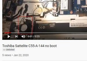

Won't boot. Powercycles constantly when under power.
https://www.youtube.com/watch?v=AXu_Q0Au...
Makes a weird sound then shuts off after half a second. Sound seems to be coming from under RAM area, on the other side of the PCB. Not quite comfortable completely removing the board quite yet, will see depending on feedback. What do you think ?

Also IF the component in the image below IS a coin cell battery (can't see it too well in your video) disconnect it as well. If it is a battery, when it is disconnected from the motherboard, measure the voltage which should be marked on the battery itself to make sure that it is OK. This may be the CMOS battery (aka RTC battery) which maintains the BIOS when the laptop is turned off. When the voltage gets low the BIOS can become corrupted and this could prevent a start etc. This usually is a non rechargeable battery and usually has a 5 -7 year life.
(click on image to enlarge for better viewing)
