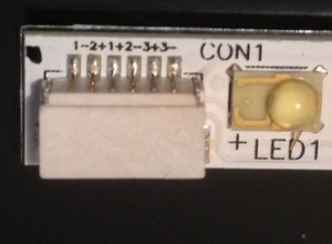

So I did take the LG LCD panel apart in search for the notorius LED Strip, see pictures:
Taking the LCD apart:
The LCD frame,
The Backlight panel,
The plastic frame,
The glass of the panel,
The back plate,
Finally getting down to the LED Strip
So I did resolder the LED connector (just added some solder to it and re-heated the 5 pins again thoroughly), but my problem still persists, the LED stripe only flashes quick at connection display port connection time. I am considering of doing some logic measurements tonight with my oscilloscope for the LED driver, but the willi fix for bypassing the 3.3V is starting to sound tempting (still trying to find out the real reason for this failure, and I have to admit that the LED stripe fault sounds more plausible to me due to the drive signal LED shutdown after one second flash.

So after all the MODs my display is running again. Eventually I ended up only changing 9 capacitors (3 pcs of each of the black ones in the pic, the orange ones I still have originals) on the powersupply,
and resoldering the LED stripe connector,
in addition I assembled and reassembled the display several times (loose connectors).
So Im still not convinced about the source of the fault and Im now testing the display for a week, lets see if it actually stays on.

I don't mean to offend anyone but you all seem to have missed the blatantly obvious and that is the LED backlight array.
LEDs age, and as such the amount of light that is emitted reduces. The LEDS in the LM240WU6 panel are made by Lumileds which is a subsidiary of Philips who in turn produced the panel under license from LG. The LEDs used are LXML-PWN1-0120 which should be operated at a forward voltage of between 3.0V & 3.6V @ 350mA and have a stated 39000 hours of life.
LEDs operate in constant current mode that is the current through the device is adjusted by altering the voltage across it. In low current LED applications this done with a simple resister. In high powered applications this is done with a controller chip such as the HV9982. Most high powered applications work as a closed loop system, that is they monitor the current flowing in the LED string and adjust the voltage across the string accordingly. The circuit Apple adopted does just that, it monitors the voltage developed across a low ohm resister in the bottom of the LED string and adjust the PWM signal to the HV9982 that will adjust the voltage to the LEDs. The suggested fix above of applying 3.3V to the PWM input will remove this feedback and will apply maximum voltage across the LEDs and is likely to result in damage to the LEDs and driver circuit.
What most people are experiencing is the backlight driver circuit shutting down due to it reaching an overvoltage point as it tries to pump more current through the aged LEDs.
(picture in the original post)
The above plot shows the current through each LED with a forward voltage of 3.3V. As you can see there is a lot of variation (LED 1 shows as 0mA), none of them get near the 350mA that they should.
Conclusion, the only long term way to fix this problem is to replace the LED string as a whole or at least the weaker LEDs. The individual LEDs are available from DigiKey but they will prove difficult to replace as they are surface mount and are tied to a heat sink back plate. An alternative is to retrofit a low voltage backlight replacement string, they are available on eBay for as low as £4. These will require a 12V supply and will need to be turned on and off manually.

I have now changed the LED bar from a donor Cinema display and it works like a charm since a week already. It always starts immedeately and the display is dimmbar normally.
LEDs age, and as such the amount of light that is emitted reduces. The LED’s in the LM240WU6 panel are made by LumiLEDs which is a subsidiary of Philips who in turn produced the panel under license from LG. The LEDs used are LXML-PWN1-0120 which should be operated at a forward voltage of between 3.0V & 3.6V @ 350mA and have a stated 39000 hours of life.
The LED strip has a sticker on it:
* P1803001D
* P66L01746

Many have identified that the problem exists in the LED strips which now are quite old and EOL. The problem for most of us is sourcing the LED strip for the 24 inch. After months, I just gave up. The 27 inch strips are apparently available on AliExpress. If anyone has found a source for the 24 inch, please post. Thanks
@teejay2000 I managed to source a LED light strip replacement from Ali. It was just £7.
It arrived very quickly from China and was very well packed.
In their listing on Ali, they state you should adjust the resistors in the driver circuit, but my finding was it worked from the off (maybe they were futureproofing for when the new LEDs will eventually go)
The link to the replacement is https://vi.aliexpress.com/item/100500618...
I can confirm it works. I did notice, however, that when you crank up the brightness to the very top, it seems to have a flicker.
You can check the LED strip with 54 to 57 volt attached to the 6 pin connector. But be aware of the crazy order of + (anode) and - (cathode) for the 3 LED strings.
It is: string1-, string2+, string1+, string2-, string3+, and string3-.
Each string draws around 10 mA at 54 V, 20 mA at 55V and 30 mA at 56 V.
