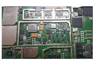

There are 2 main problem that make Pro4 could not turn on with battery
1. Schottky diode failure, test by using analog multi meter with ohm x1 measure compare with the other schottky diode below ( lift the mainboard and insert plastic sheet to isolate the battery before measure )
2. the battery control board was failure, battery of pro4 have 4 fuses, if one fuse was blow off it make pro4 can't turn on.
Could you please provide a link for the diode, and/or the part number?
As other said, it could be other parts as well. Also there is always the risk of damaging the screen, because its glued to frame.
https://cutt.ly/OjasPi1
Interestingly enough, apparently, there is a spare diode available on the board already:

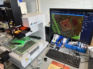

I had the same issue : no reaction of the Surface Pro 4 after a battery replacement.
The Schottky diodes were Ok, same for the shunt resistor.
I found the issue and succeed to solve it, by replacing the IT8528 chip on the board, using a rework station available at my work.
The Surface works again, almost a month after the bad repair.
