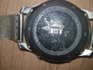

Mine went off and stopped charging. Checking the back I saw that the plastic lid was completely crushed and looked wet inside.
I removed the plastic lid and waited for it to dry, turning it back on, but I couldn't recharged it, I think it could be the contact or because it's broken the plastic lid that comes with apparently the wireless charging system.
