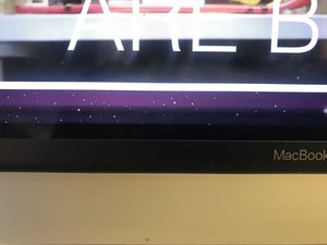

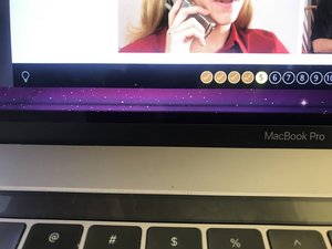

I have a 2016 macbook touchbar 13" and one month after the 1 year warranty I noticed this "stage lights" issue. 5 months later the issue is worse now.
Yesterday, I noticed that when I tilt the screen back beyond the 90 degree angle the screen goes black. Then if I move it back to 90 degrees it gets illuminated. But the angles vary a lot. Sometimes it gets illuminated only If I move it back to 60 degrees and sometimes a little more than 90 degrees.
One important thing to mention: when I open the lid until 60 degree there's no stage light issue, the display is clean, with no shadows. The issue starts at 60 degree with the shadows appearing and screen brightness being lowered until it goes black.
It works perfectly with an external monitor. So it must be something with a damaged display cable, right? Can it get worse than it already is, like damaging the logic board or something?
I can't afford an expensive repair (new display) so if I'm safe keeping the lid closed, I'm planning to use it as a desktop.

Apple appears to have a run of displays failing in the new 2016/17 models!
Sadly, the cable between the backlight within the display and the connection to the logic board is the issue here. The flexing of the display (opening & closing the lid) fatigues the wires within the ribbon cable. The complete lid needs to be swapped out.
Apple will likely issue an extended warranty for this (free repair). I would still make the effort to visit an Apple Store so its on record if you can't afford the repair now. They may even just repair it under warranty!

same issue on my Macbook Pro 13" (2016). would you know if they replaced the whole display system or just the cables?
They are replacing the display assembly as unlike the older models the cables are soldered directly on the display and go to a second logic board (T-CON) with is held just above the main logic board. Take a look at this image T-CON & logic board. If you look at the top you'll see to clips which hold the four cables from the lid on the T-COM board. The 3rd cable from the left is the backlight cable.
Thanks Dan! Looks like i got to spend more coz of this hardware config

FYI: Apple repaired our 2016 MacBook Pro  (MacbookPro13,1) at no cost.
Apple published a service repair fix on 5May19:
https://support.apple.com/13-inch-macboo...
Note: the repair part was p/n:  605-20954 - Display Assembly, Silver
I went to an Apple store and rep initially said repair was not covered. I showed him the above link, then he said .....I did not know about this - this was new info - he did not know about this repair service program.
Check to see if your model is included.

In all the cases we have seen, the issue is with the backlight LED cable which is soldered and runs deep underneath the LCD and cannot be replaced. The eDP (Embedded DisplayPort) LCD cable almost does not spoil. In our experience the eDP LCD cable only gets spoilt in liquid spillage cases.
If you do get lucky and that's the part that requires replacement, then yes you are in luck. It's probably less than USS $100 in most countries.
