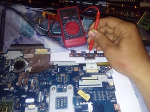

eMachines e625 kawg0 model won't turn on
Hello, I'm beginner specially in hardware , i wish that you can help me,
i downloaded the schematic and i made some checks : i tested the power cable it work , and continuity in power button , and now i don't now what i should test to find the problem because i can't understand the schematic
You may have a dead CMOS battery. I had an eMachines computer that appeared to be dead; I replaced the CMOS battery, and the computer came back to life.
Also, check the power cable that plugs into the motherboard. Make sure that each wire has the correct voltage. You likely have an ATX power supply (most computers do). Go to the following web site to see some very good diagrams which show the correct voltages for the main power connector (the one that plugs into the motherboard), as well as for the Molex and SATA power connectors:
http://www.smpspowersupply.com/connector...
If all of the voltages show to be correct when you test them, then replace your CMOS battery.
I tested the power cable , the cmos battery and also the power button all work, i want to continue tests but i can't understand the schematic
Schematic:https://drive.google.com/open?id=1qq1xow...
