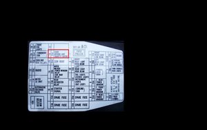

My interior lights quit working
Hi @alookisatoy ,
Are the clock and the cigarette lighter still working?
If they're not working either then check that fuse #14 in the fuse block under the dash is OK and is not blown.
(click on image to enlarge for better viewing)
