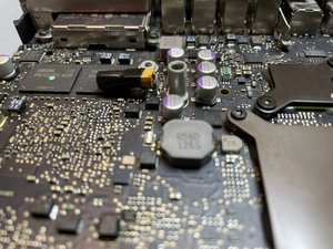

I see that this is becoming an old post but I wanted to add some testing that I’ve been doing on a 2011 Mac mini that was given to me. It exhibited exactly the same symptoms as other here are experiencing where the computer power indicator (sleep indicator?) comes on only for a brief moment when the the power switch is pressed. I’ve been working on this on and off for about 4 months… not wanting to give in.
I also noticed that as the unit was plugged in, the power indicator would flash momentarily even without pressing the power button. Other Mac Minis that I have do not do this. I did a number of tests looking for shorts and other irregularities on the logic board but found nothing. In the back of my mind, the GPU issue of the 2011 MacBook Pro was always present. And, there was a similarity with this and the HP G62 which suffered a similar fate. The computer would not start, but the caps-lock would flash.
I decided to add some solder past and do a reflow of the AMD GPU. At this point I really had nothing to lose because it didn’t work anyway. I applied almost 500 degrees Fahrenheit for 2.5 minutes using a rotating motion of a SMD station. After letting it cool down, I plugged in the Mac mini and the power indicator did not flash this time. Next,I pressed the power button and the computer immediately started up. It ran long enough for me to do a full installation of High Sierra. I let it run for a while and after some undetermined amount of time, the computer shut down on its own.
I was able to start it up again but I found it to be unreliable as it would crash and restart while trying to start up.
To sum this up, it appears clear to me that the reason so many of these 2011 models were no longer starting up was due to the failed AMD GPU. Of course, what I’ve done in no way is a fix. We all know that these GPUs cannot be repaired, but it appears to me that the GPU is the reason for the failure.
I challenge others that have the opportunity to do this same test, do so, and come back with your results.

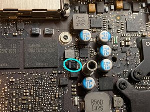

Update (01/26/2021)
OK, it looks like I have solved the problem at least on my Mac Mini. My Mini is a 2011 i7 with an AMD 6630M GPU. I can’t speak for other models that don’t have an AMD GPU, but I think if you have this same problem, it will apply. This problem is a fault on the logic board. I don’t recommend this repair for anyone that is not comfortable doing SMD work. It is best left to qualified technicians.
To do the repair, you will need to remove the logic board from the case and flip it over so the fan area and CPU side are facing down. Align the board so the USB, Thunderbolt, etc. connections are facing away from you. Locate the metal shaft on the board that is used for the long screw of the fan. Just to the left of it you will see a small capacitor with the white label “N8 de” and a “+” sign. This is the bad capacitor. It’s a 330uf 2v capacitor. I replaced it with a 330uf 6.3v capacitor, which is much larger. I used wire stand-offs to elevate the capacitor so it cleared other components. You are welcome to find what ever replacement works for you. The operating voltage of the VR is 0.99v. Be careful not to use high heat close to the memory chips that are along side this capacitor. I was able to replace the part by using only a soldering iron.
The Mac Mini is now working perfectly. It comes on properly without doing the quick on/off that is was doing before and I am very happy to see this working after looking at it on and off for the last 18 months. I wish you luck on yours, and as I say, be very careful when working on this. a mistake could be costly.

Hi Al Sharpe, same model Mini with I7/AMD here. I've identified the cap you mentioned, and it looks fine. Was there any visual indication that the cap was faulty for you, or was it only through testing that you identified it as faulty.

Hi Mike. There is nothing visual about this capacitor that makes it look bad. I determined that it was bad by applying heat to it and turning the computer on. These caps are heat sensitive and heating them makes them work again temporarily. If you can, replace it to see if this works for you.

Have you read over my note about the bad capacitor?
The problem you are having is definitely capacitor related, but you may have the reverse condition that I experienced. It sounds like the capacitor on yours goes bad when it heats up, and is good when it is cold. You could try waiting for it to stop working, then use cold spray in areas of the board until you notice that it starts up again. That’s what I did but I used heat instead. From there you need to work down closer to the point where you could cool one small area to identify the component. This is my only experience with a 2011 Mac Mini but I’m sure that you will find the problem. Don’t be discouraged if it takes a while. The MacBook Pro A1278 had a similar issue with the GPU regulator capacitor C9560.

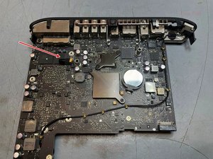

I wanted to share my experience with a No Power/No Light scenario with a Mac Mini A1347. Mine was the 2011 i7 model with the Radeon HD 6630M. I tried replacing the power supply, no change. I disassembled the mini down to the logic board, checked the power switch, and measured voltages while plugged in, every voltage was present and checked out. Determined, I tested all the caps and noticed that the three yellow tantalum caps were reading shorted. Using a multi-meter in diode mode confirmed, 0V drop over all three caps. And in impedance mode, they all read 0.2 Ohms. Researching what I found on the logic board this website: https://logi.wiki/index.php/A1347_2010-2... highlighted the exact caps. I went through the painful process of removing the caps, which required using hot tweezers and was not easy. This board soaks up heat like no other board Ive worked on. Required an enormous amount of heat, and the HT140 hot tweezers were the only way to get the caps by the ports off. Cleaning up the pads was also difficult on the Ground plane side because of the heat absorption. But eventually got them cleaned. I used replacement caps T520B157M006ATE035‎ and solder paste with a hot air iron at 50% air and 440 Deg C. After assembly the mini turned on right away. Apparently what happens is the polymer tantalum's fail shorted. Indeed only one of the three caps were shorted. This permanently puts the 5v rail grounded. These caps are involved in the USB ports and Firewire ports, so either heat or a device plugged in kills them. Hope that helps someone.
