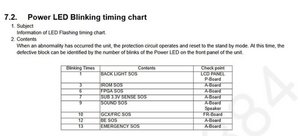

If it is blinking here’s a link to the Power LED Blinking timing chart, taken from the TV service manual
If it is blinking continuously without a pattern this is the most difficult problem of all to find. You would need to start with the power supply and work you’re way through the TV as to what the problem may be.
If there is a pattern to the blinks it is easier as the blinking timing chart tells you where to check first.
If there is no power LED then here’s the link to the No Power troubleshooting flowchart that may help.
The manual shows how to remove the boards from the TV and also has full schematics which is a great help.

Hi @bcoy
Is there a count pattern to the blinks?
Click on the link for the "Power LED blinking timing chart" in my answer just above, to see what the problem may be. I realize that it is not the same model but Panasonic usually use the same LED error codes for all their plasma TVs

Hi @Betty Garcia
Are you sure that the red light blinks 4 times?
Looking at the blink error codes from the service manual for your model, that code is not there.
(click on image to enlarge for better viewing)
Maybe you should still check the A board for any obvious component damage.
