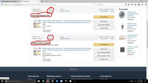

I also had this problem with an iphone 7 plus that came in and I had 3 different drivers I bought from 3 different places and also the free cheap one that came with the new screen replacement.
I ended up having to take a straight screwdriver I got in one of my iphone 6 replacement screen kits and taking a file to it, looking under a scope and an hour and a half of tinkering with it to get them all out to get my customers phone completed.
Since then, I have returned 2 of the Y000 to amazon and tried 2 other suppliers there, went to ebay and bought one from the UK.
This was recently, so they have not came in yet but will keep you posted on which one works best. But with 4 different tips from 4 different places and still no luck finding a good one, I think its gonna be hit and miss with finding a good one.
BUT...the file and cheap straight one got me past the immediate need, but did have to use magnification to get it just right.

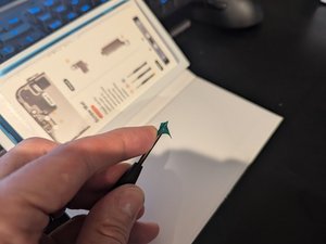

The problem is that most of the drivers are too pointy, and the screws arw nowhere near as deep. If you take some fine sand paper and sand or file the tip flat so that when you look at the end of the bit under a light you’ll see a “Y” shape that’s rather thick or “bold”, instead of a sharp point, or a very thin “Y” shape that’s not well defined.
Remember though, don’t keep trying bits that don’t grab right away. every attempt that fails to turn it will take a little more metal from the screw.

Ed you're the man! Just the advice to sand the tip to remove the point and blunt it up a little was exactly what I needed to do!
I also feel like the problem is the that point is too pointy for the shallow screw heads. I was thinking about filing the point down, but wasn't sure.
Glad I could help!
GENTLY sanding the point flat is the correct answer, you don't have to worry about Ed's update though what was said in the update isn't wrong, just extra.
I say this because my personal ifixit kit had overly sharp tri-wing bits for the incredibly shallow iphone screws but I never really noticed until recently because most of my apple work is at the shop.
JUST A FEW passes on a tiny strip of 200grit sand paper was all it took to take my ifixit Y000 from "too pointy trash" to "you again weild the screw driver of the gods and it fits everything perfectly". Note that the millimeter or less being removed will not affect usage in deeper screws. (this is a good trick for restoring most pentalobe drivers that are wearing out too).
