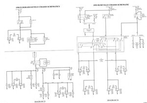

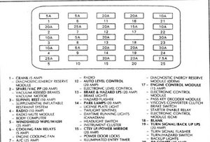

Why aren't my turn signals working?
I own a 1996 Cadillac deville. My hazards work just fine but my turn signals don't. I replaced my flasher and they still don't work. What could this be? Is there another fuse I'm missing?
@anthony555 fuse 19 is your indicator fuse
and attached is the wiring diagram that should help you out for further troubleshooting
