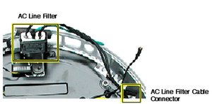

10. Check the AC line filter. To measure power at the AC line filter cable, disconnect the AC line filter cable from the power supply cable. Switch your multimeter to read AC voltage. Touch the black probe to the pin of the brown wire, and touch the red probe to the pin of the blue wire (see graphic below). Do you measure 120v (line voltage)? If yes, go on to step 11. If no, replace the AC Line Filter.

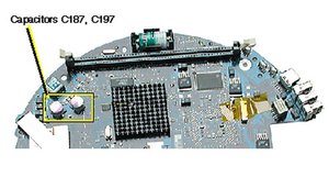

12. Check the main logic board voltages. Measure for +12v DC at capacitors C187 and C197 (identified in graphic below). Ground the black probe to the logic board screw next to the battery, and touch the red probe to the positive node at capacitor C187, and then at capacitor C197. Do you measure +12v? If yes, go on to the next step. If no, replace the logic board.
