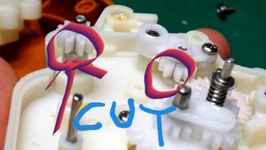

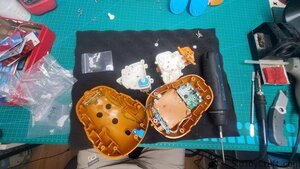

Gearbox gear repair.
It seems to be a fundamental problem for the product.
All the problematic products are the same gear problem.
The two gears in question must be repaired by opening the gearbox.
It would be easy to get the same gear, but...
A gear is cracked.
The thickness of the steel pipe in the middle is larger than the gear hole, resulting in a crack.
Secure the cracked gear with glue and expand the hole.
Grind steel pipes to make the hunger thin.
https://youtu.be/4QJFvA5n3gs
업데이트 (2019년 10월 23일)
The cracked side of the gear needs to be cut and glued. This ensures a constant gap between the teeth.
The gears were first disconnected and then polished the bumpy part of the metal pin.Cut off the cracked part a little and fix it with a force adhesive. Apply a little glue to the metal pins and fasten them with the gears.

@weirdalfan1 No, i have not. Cut off the cracked part of the gear. Because it is to fit each gap in the gears. This is important.

Step-by-Step Fix
  1. Disassembly: Document each component’s position and assembly order with photos.
  2. Gear replacement: Swap the damaged gears with precision-matched custom gears.
  3. Lubrication: Apply silicone-based grease to all moving parts.
  4. Reassembly: Reverse the disassembly sequence strictly.
Simply using glue to repair a broken gear often doesn’t work. Initially, I tried that approach too, but the result was that it still jammed. Because the gears in Mr. Potato Head are very precision-engineered, I ended up repairing it successfully by replacing the gears with custom-made ones
