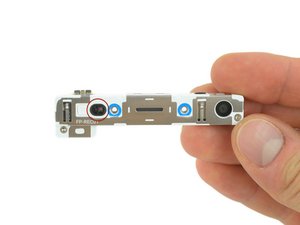

Hi, had the same problem and just solved it by disassembling the screen and blowing onto the sensor and wiping the inside of the screen where the sensor sits when the screen is attached. Also the screen protector had slightly moved over the edge of the sensor area and had a little dust in the hole for the sensor. Hope that helps. Best, Jesko

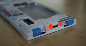

I wasn't able to do it that easy either. It took a little more effort. I placed the phone flat on my hand, screen up, bottom of the phone facing away from me. (After unlocking the blue locks. Note that there is a final click, so make sure the locks are all the way open.) Then with my index and middle finger I grabbed around the bottom of the phone where the blue locks are now (or somewhere you dont block the screen from sliding down) and pressed my other hand flat on the screen and slid the screen down.
Don't apply too much pressure to the screen. Try to use as much surface of your palm as you can. If you have dry hands breathe onto the screen first or even use a rubber glove to have the necessary grip.
That did the trick for me. Hope that helps!

Thanks Jesko for your two messages : I tried by using rubber gloves (very good idea), but did not succeed : the screen moves by less thatn 1 mm, and then blocks. Impossible to move the screen further out...

I had the same problem. I've used the proximity sensor app, under "settings/maintenance" to solve it. It works!!
I also had troubles with my proximity sensor. Some dust was deposited between the screen and the sensor's lens, blowing it with air solved the problem. Thanks for the tip!
Recali rating the proximity sensor, did the trick!
Thanks for the advice
Hey,
Your proximity sensor is damaged. They are light sensitive, and usually near the earpiece on the handset. It may be disconnected or need to be replaced, to resume full functionality. I have circled it in RED. Possibly open and check the connections with this handset.

I have the same problem (proximity sensor not working), but I do not succeed to open the FP2 : I followed the tutorial, but impossible to dismantle the screen, as if something was blocking the screen to slide.
Is this move (slide the scrren to take it off) so difficult ?
Is there anything I don't do properly ?
Thanks for your tips ..
Alain
Hi Alain, I hope you've been able to get the cover off by now? I also had a few problems at first. I watched the video linked to above. I thought it would be easier, but I basically was able to open the phone when I put a little pressure exactly where the guy in video show it. I.e. Left thumb pressure on the area left of the sim slots and right thumb pushing pressure to slide the phone upwards. I hope that helps...
Hello there, I just want to say that I had the same problem. I followed the advice above and blew on the sensor and hole on the screen side, as well as using a soft, fine, dry water colour paint brush to remove any dust. Even though I couldn't see much dust on the sensor it seems to have solved the problem, so thank you :).
This was the first time I've taken the phone apart at all to solve an issue with it, and did notice a small amount dust and fine sand in some of the other parts of the phone. I guess letting in a bit of dust might be a disadvantage of a phone that can be taken apart very easily, but given the ease of the fix it's not too much of an issue. Maybe dusting the fairphone's insides every now and then should be prudent maintainence - and another reason to have a gawk at the modules up close.
