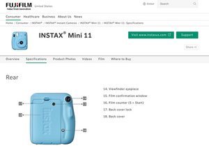

S means it’s on selfie mode
"S" stands for start
Well that was the case with mine and when I switched the modes it went back to counting down the numbers. The little house mode turned the numbers to the S and when I rotated the mode to the little sun it went to the numbers.
I hadn’t realized it was even an option to rotate those modes and the pictures were coming out completely white. Anyway tested it by taking a picture facing selfie and it worked. Messed with it til I realized I could rotate the modes.
@Anahi Gutierrez "S means it’s on selfie mode" = NO
"S" stands for START... the first time you take a photo it will release the plastic cover... that is why there is an "S" before the 0 (ZERO)
