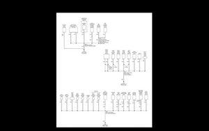

Hi Len Perras ,
G102 and G304 are ground points connections in the vehicle.
These two images show the location of G102
and G300
(not sure about G304 now as the only ground distribution wiring diagram I could find was for a 2000 Pontiac Sunfire SE) but it shows the ground wiring for both the front and rear turn indicators so hopefully it is of some help.

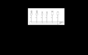

Can you hear the flasher unit operating either when in hazard mode or turn signal mode? If not and if your brake lights are working and the turn/backup fuse is OK it could be that you have a faulty ground connection to the flasher module. Here is an image showing the relevant details.
If you can hear the relay operating it would be unusual for both front and rear lights not to work because of a faulty ground connection, as they are connected to ground at different parts of the vehicle.

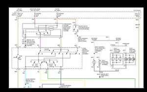

The following is based on the circuit provided above (your vehicle may be different)
To check if there is power you need to test for power at pin 1 of the flasher unit with the ignition key in the On or Run position.
if there is no power on pin 1 of the flasher unit (with the ignition key turned on), first check if there is power at the fuse. It may be faulty wiring from the ignition relay to the fuse position.
If there is power at the fuse then it may be a faulty connection on the back of the fuse block for that fuse, or a faulty connection on pin 1 of the flasher unit or anywhere in between. You could also check that the connectors that hold the turn fuse in the fuse block are OK and have not either "burnt away" (use a strong light and a magnifying glass to check) or have enough tension on the fuse.
If there is power at pin 1 of the flasher unit, the earth that "tells" the logic circuit that the relay "needs" to be operated comes from the lights and it is the same earth for both the turn signals and the hazards BUT it appears at two different connectors in the flasher unit coming from two different contacts in the hazards switch. For the turn signals it is on pin 4 and for the hazards it is on pin 3.
So it could be a faulty connection or wire between the hazard switch (E terminal) and the flasher unit (pin 4 -on the circuit it is shown as a purple wire) or it could also be a faulty hazard switch contact individual to the turns circuit
