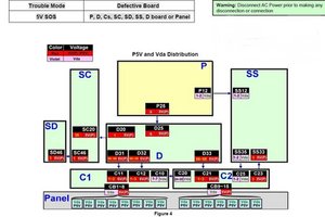

ttibal, get the multimeter out:-)
5 blinks condition can be caused by:
Missing P5V
A short of the P5V
A short of the Vda line (Note: missing Vda from the P board does not cause 5 blinks)
Wrong diagnostic by the D board
check the voltages as indicated. Attached documents will show how to test each one of the boards for the 5 Blink error code.==>> LED-5-Blinks.pdfLED BLinks 5X <<==
